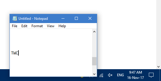

    After recent update I find that my Windows 10 Taskbar is not Always on Top. If I open a desktop application, the Taskbar hides behind it. How do I make the Taskbar remain always on top?
    Where is the setting? I remember seeing it sometime.
