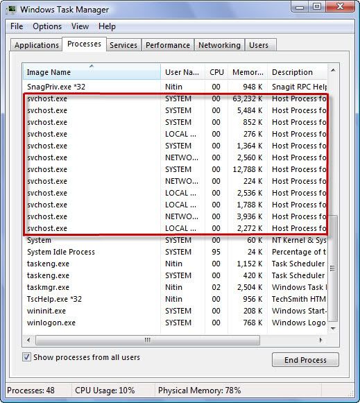

    Svchost.exe is a process on your computer that hosts, or contains, other individual services that Windows uses to perform various functions. For example, Windows Defender uses a service that is hosted by a svchost.exe process.
    There can be multiple instances of svchost.exe running on your computer, with each instance containing different services. One instance of svchost.exe might host a single service for a program, and another instance might host several services related to Windows. You can use Task Manager to view which services are running under each instance of svchost.exe.
    To view which services are currently running under svchost.exe
    1. Open Task Manager by right-clicking the taskbar and then clicking Task Manager.
    2. Click the Processes tab.
    3. Click Show processes from all users. If you are prompted for an administrator password or confirmation, type the password or provide confirmation.
    4. Right-click an instance of svchost.exe, and then click Go to Service(s). The services associated with the process are highlighted on the Services tab.
    Note: If you install a program and begin receiving notices that Data Execution Prevention (DEP), a security feature of Windows, is closing svchost.exe or other Windows processes, the cause could be services or extensions created by the program. Check with the publisher of the program to see if there is an updated, DEP-compatible version available, or try uninstalling the program.
    More here on svchost.

    Oh damn I got a huge bunch svchost running in the background
  9. #9
    whs's Avatar
    whs
    whs is offline Gold Member
    Join Date
    Oct 2008
    Posts
    1,420
    Default
    Kundoh, this is normal. You will have a dozen or more. Download and run Process Explorer . When you hover over the individual SVCHost.exes, it will tell you what they are used for.
